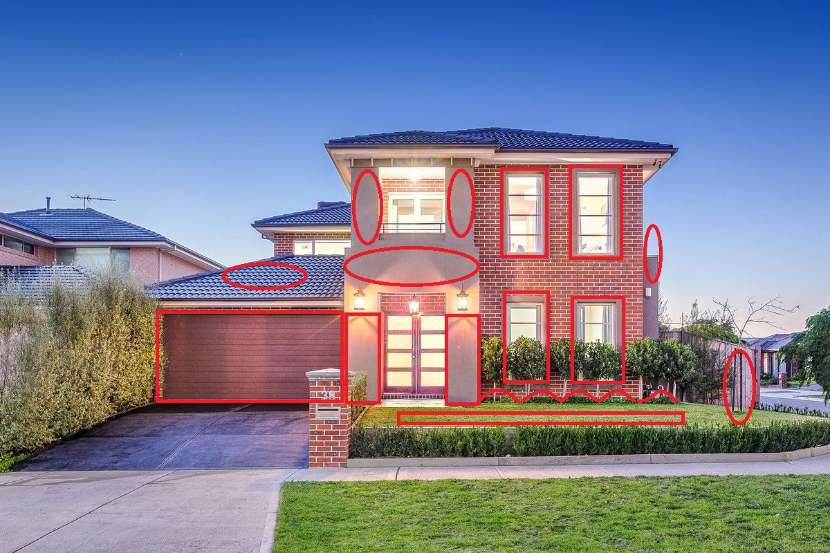

Thanks All,
I was thinking originally about the F16v3 as I was going to keep everything central.
I've since looked at my front yard and highlighted all the areas in red that I'd like to eventually run props to, there's quite a bit there and I think it would make sense to have smart receivers at key points around the yard, even if I'm not going to set them up this year I can buy the receivers now and do it a piece at a time.
Saying this that's why I'm thinking about the K40D vs buying anF48 and having 4 smart receivers to start off with.
Happy to get some thoughts from everyone.

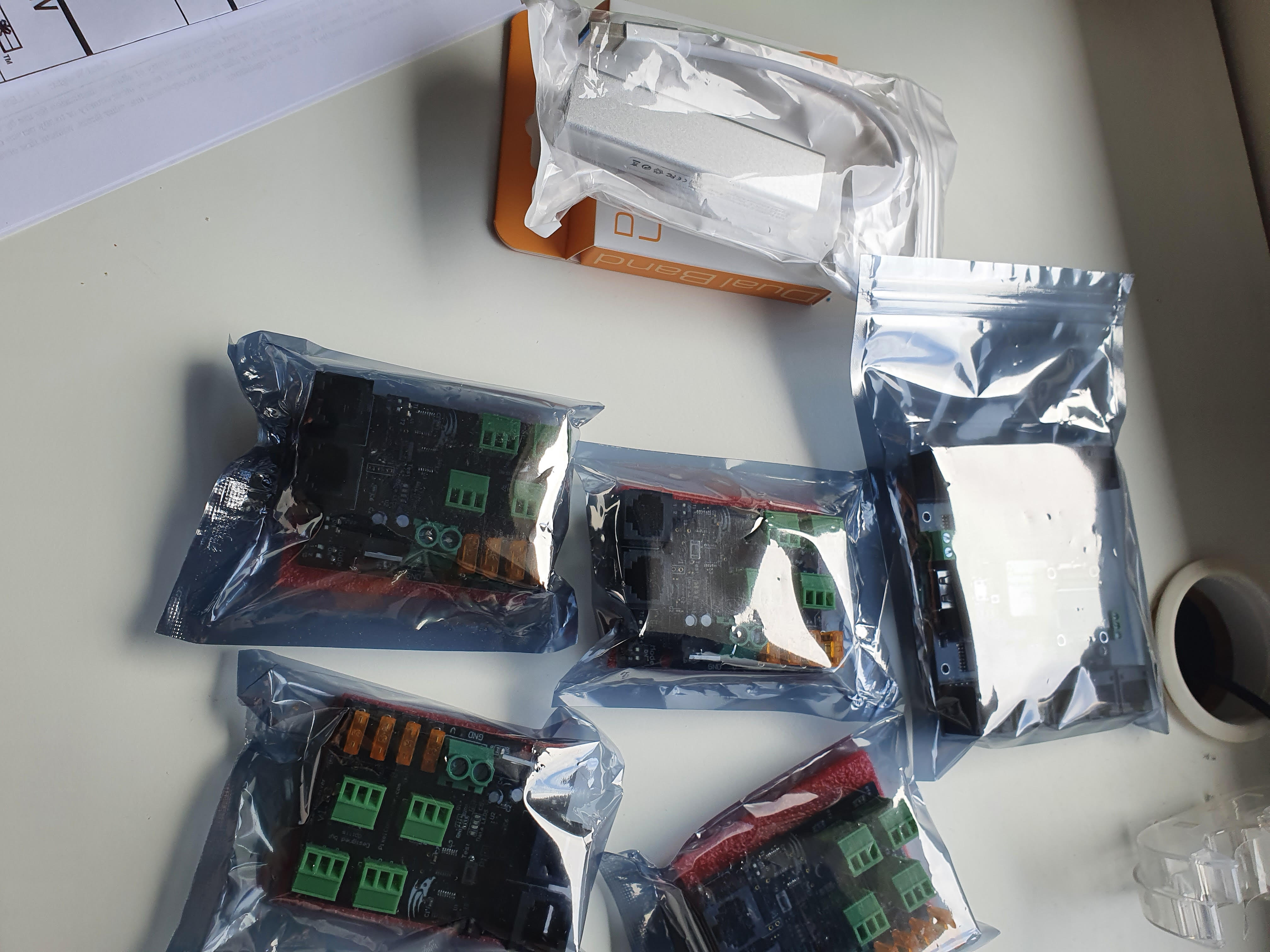

Ended up buying the K40D and four smart receivers last night.
I figured I might as well buy the hardware and force myself to start using it instead of just reading online and reviews.
Hopefully next week I'll have everything I need and can start experimenting for my easter lights.
