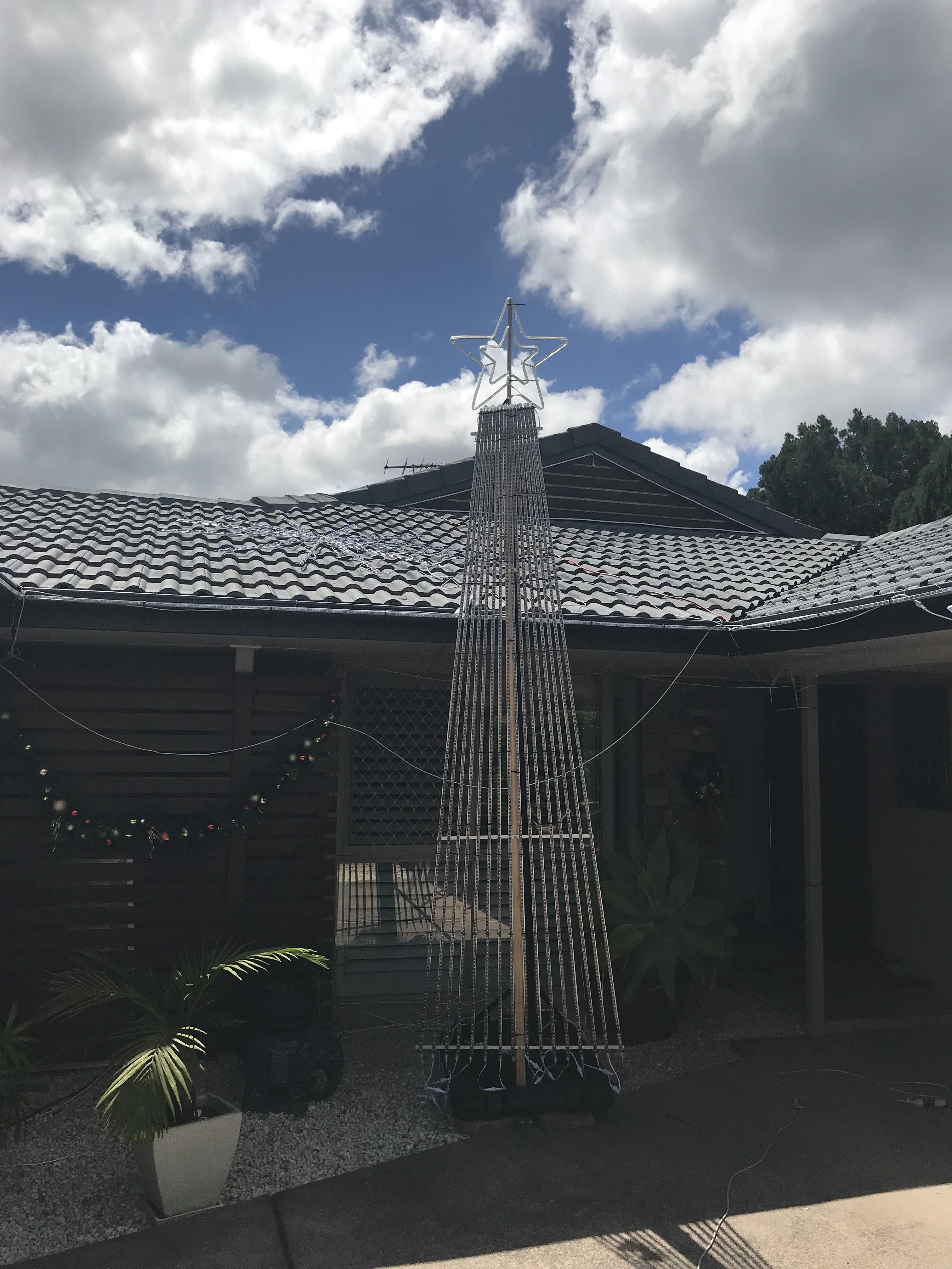

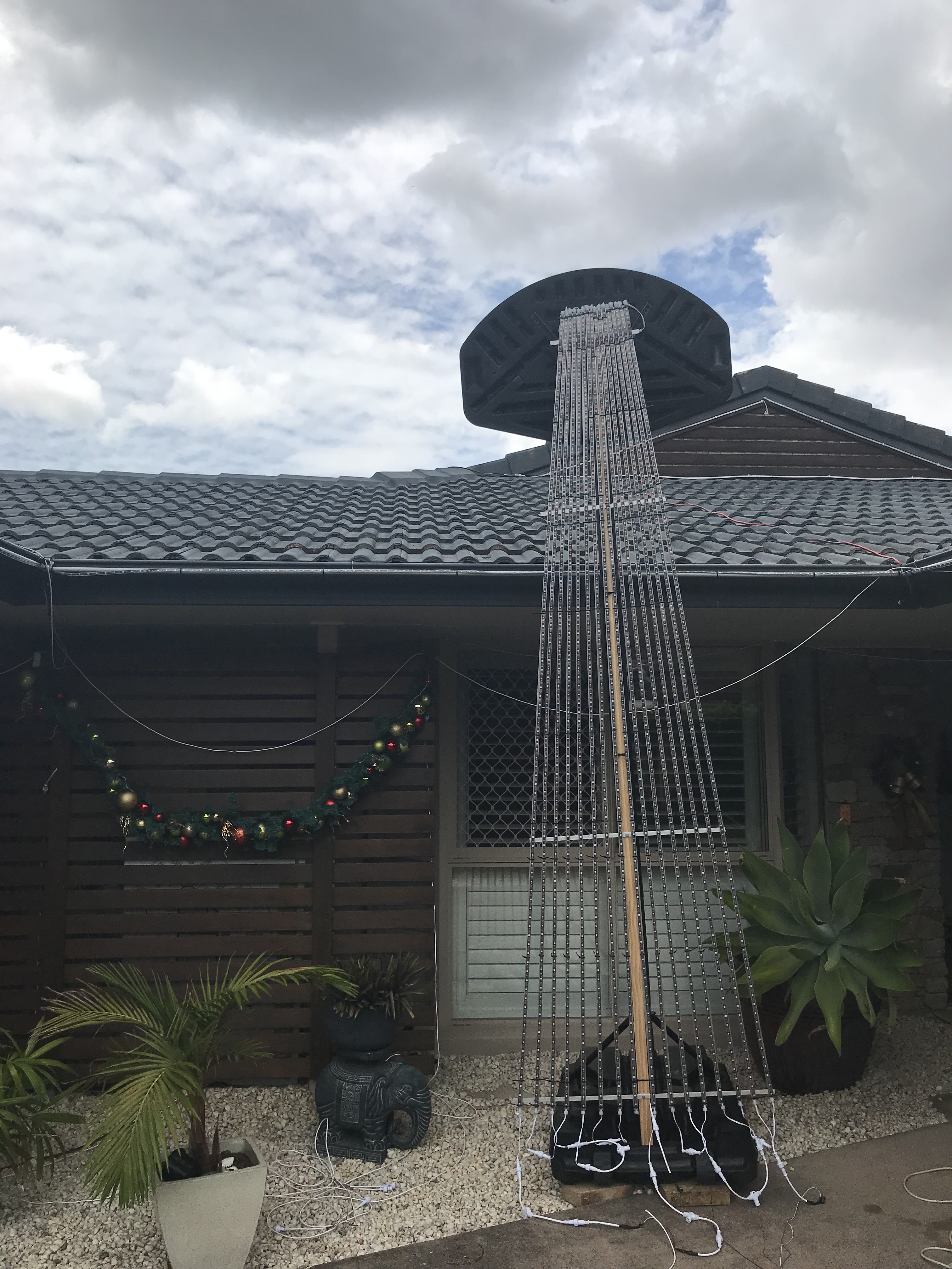

A big weekend just gone. Other than getting sunburnt, managed to get the big ticket items out and on display. First up was the tree. That was a battle. Luckily enough I had the basketball pole and base. A few cable ties and on it went. I originally left the backboard on when I added the tree, but after standing back and looking at it noticed it blocked a lot of the middle triangle on the roof, so off it went. What a battle that was as the bolts were rusted. But it came off. Note to self for next year - fill the base up with water before adding the tree. Due to the location of the filler, its half full. Will need to get Mrs QldKing involved to help me fill up more of the base with water.
After taking the backboard off it did look a bit plain on top, so I added a star to it. Looks quite good.
Next was getting the spinner on to the roof. Very happy with how that looks. It's just the offcuts from the tree aluminum, so each arm (12 in total) is around 900mm long (you can see it on the roof in the photo with the star on the tree).
