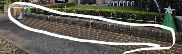

Yep ok. So the whole strand would be replaced. im thinking of making one for my front fence. 5 strands of roughly 150 pixels (roughly 7.2m long each strand). just not keen on having to pull out the whole strand.
