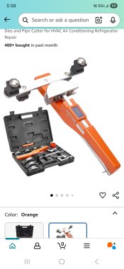

Hello all. I was wondering what everyone used to bend their pipes or tubes for their displays? I was thinking about buying something like this. Please let me know if this would work for bending a frame for an arch ECT...

So for these sorts of things it would be best to post the link to the product instead of a simple image. The image does not provide enough information. Based upon some of the text that can be seen that looks like a kit for bending copper a/c lines and not electrical conduit. There are a few different ways to bend conduit for arches.
