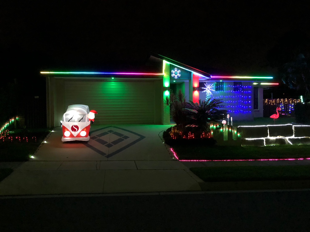

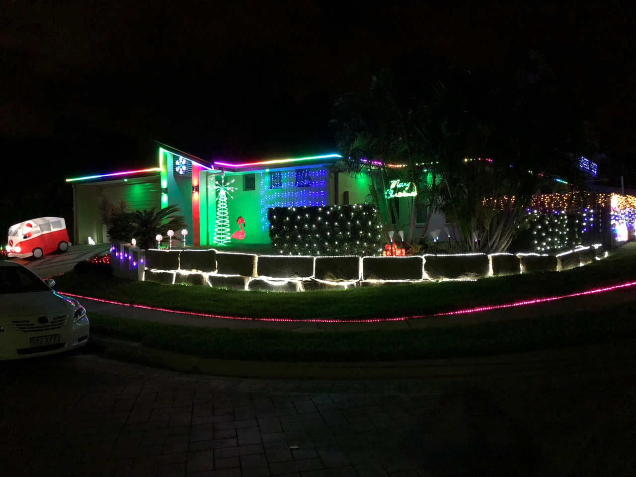

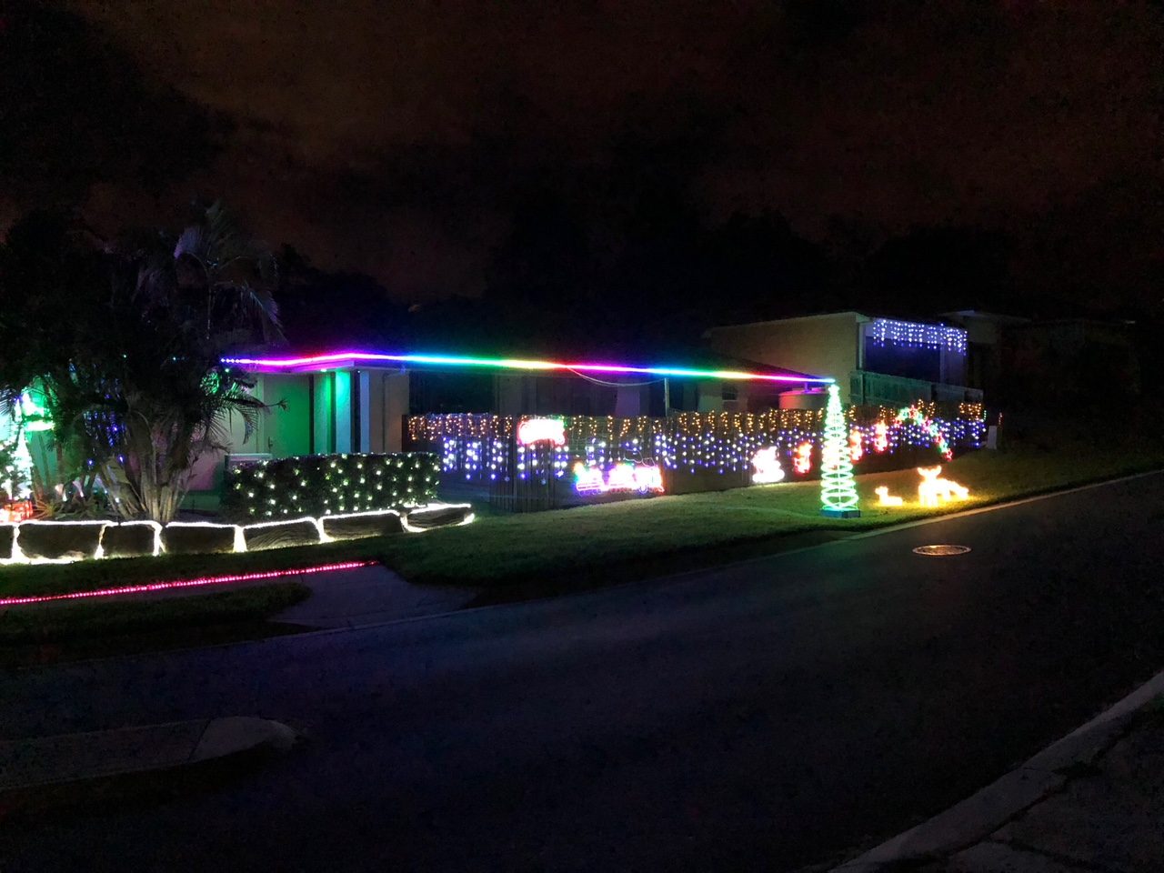

Hello my name is Graeme from Brisbane, Wakerley 4154. Came across this site as I have been searching for new types of Xmas lights which seems a struggle. It's all the same same. Have spent around 4-5k from retail stores over the last 2 years. Got the gutter light in a full kit controllable with a remote from eBay in Korea. Beyond this i have installed RGB downlights that allow you to change the colour with your iphone app & also RBG bulbs in the coke can style lights beside the entry. Keen to try something new especially with the gutters roof etc. Below are links to my display
http://www.bamgarage.com/images/acl/22.png
http://www.bamgarage.com/images/acl/33.png
http://www.bamgarage.com/images/acl/44.png

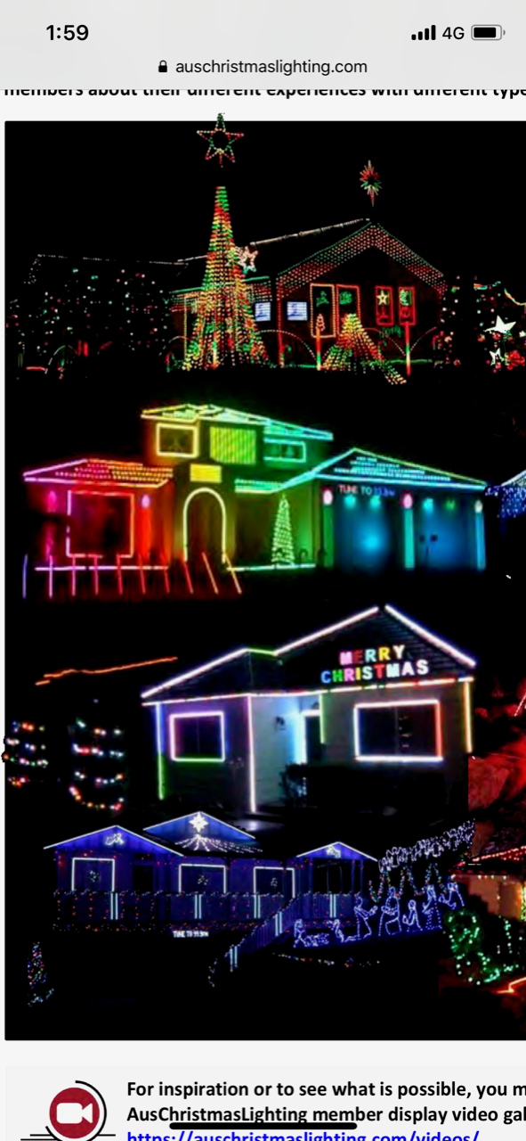

I have taken a screen shot of something that I would like to do from the auschristmasgallery (the one in the middle)
http://www.bamgarage.com/images/acl/55.png
I have read most of the user manual so far. The idea makes sense but a lot of words and finer details are beyond me. I suppose if someone could help me compile a shopping list I could make it a success? Once i have everything infront of me it should make it easier for me to figure it out. Not sure if anyone is keen to help and if you can throw a guesstimate out there as to how much an intrecate display like this would cost just roughly to the nearest thousand.

Start with your sequencing software ... most use xLights a few Vixen ... draw up your house to decide what you want.
Most get their lights from Ray or Paul in china.
Bullet pixels around around USD$20 for 50. power supplies about the same and they will run about 8 strings or so depending on brightness. A falcon controller will run you to USD$200 or so depending on configuration. Good for 10-16K pixels again depending on layout. Pigtails etc also need to be bought.
If you go with Coro props add $50-100 each mostly due to shipping.
Availability this late in the year on some of these items can be tricky so move fast.
All up 2-3K you can get a decent start ... big displays cost more.

That's a really nice display you have already. The corner block would look great when its all setup. Not sure where you want to get to this year.
