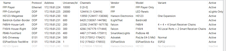

3. Yep You just define multiple controllers. No issues mixing brands. I have 5 different brands in my show (I'm counting all the different FPP based controllers as as a single brand):
