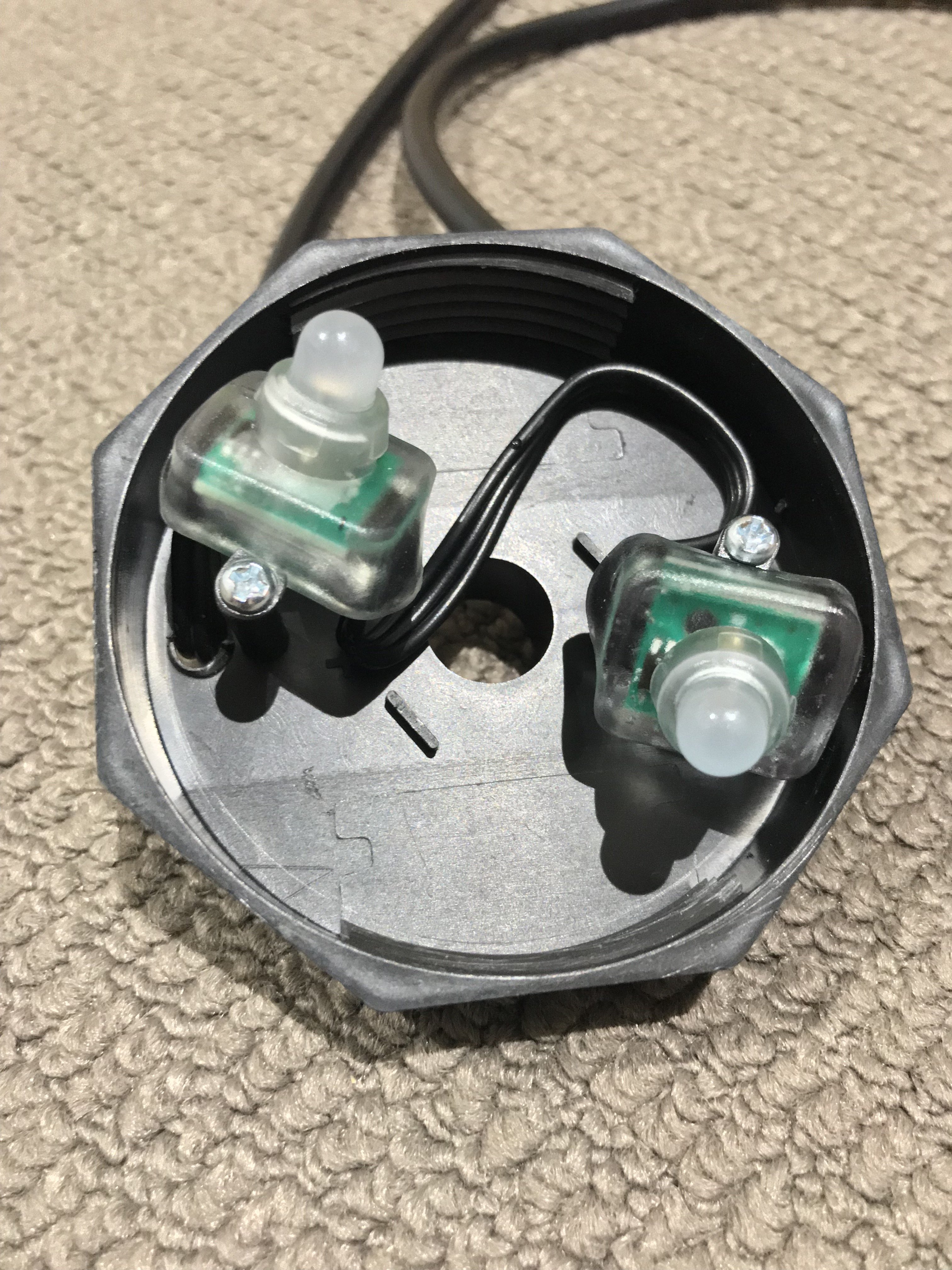

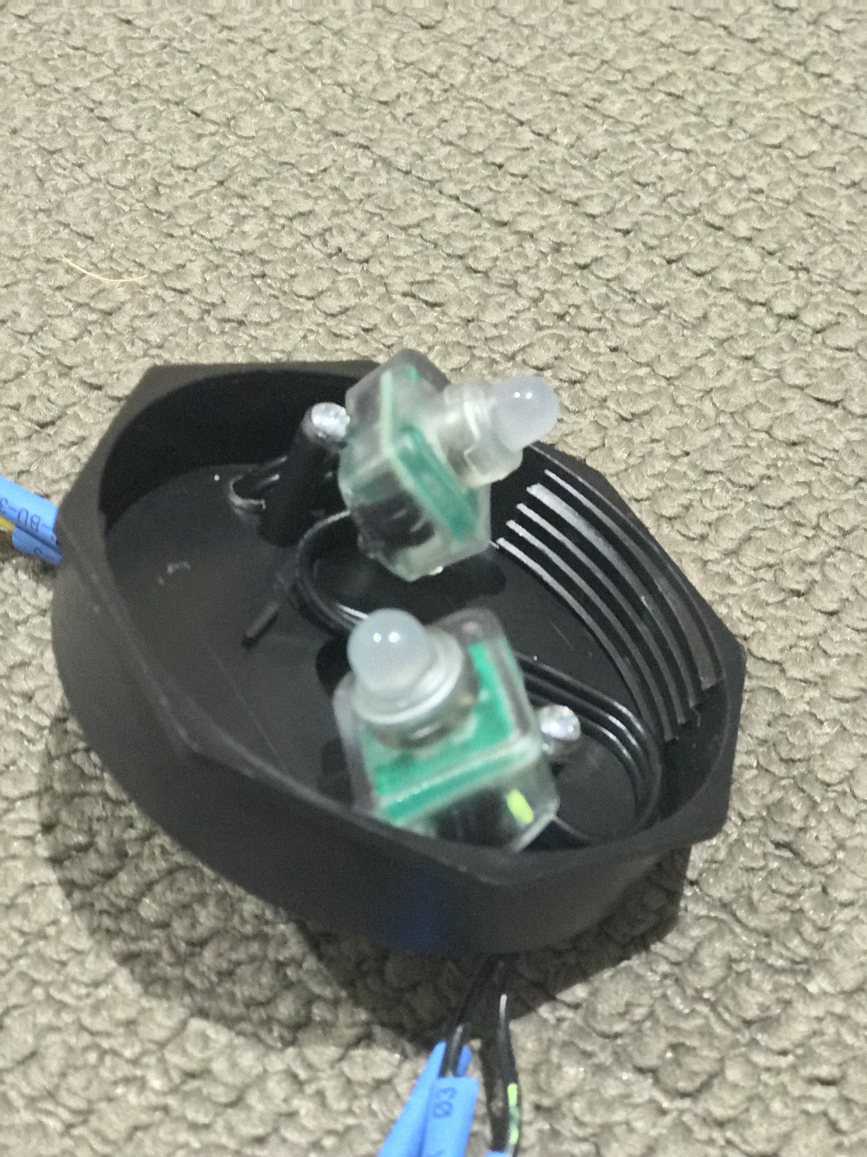

If anyone is looking for an alternative, I ordered a set of 5V 2811 LED pixel nodes with 50cm pigtails from Ray.

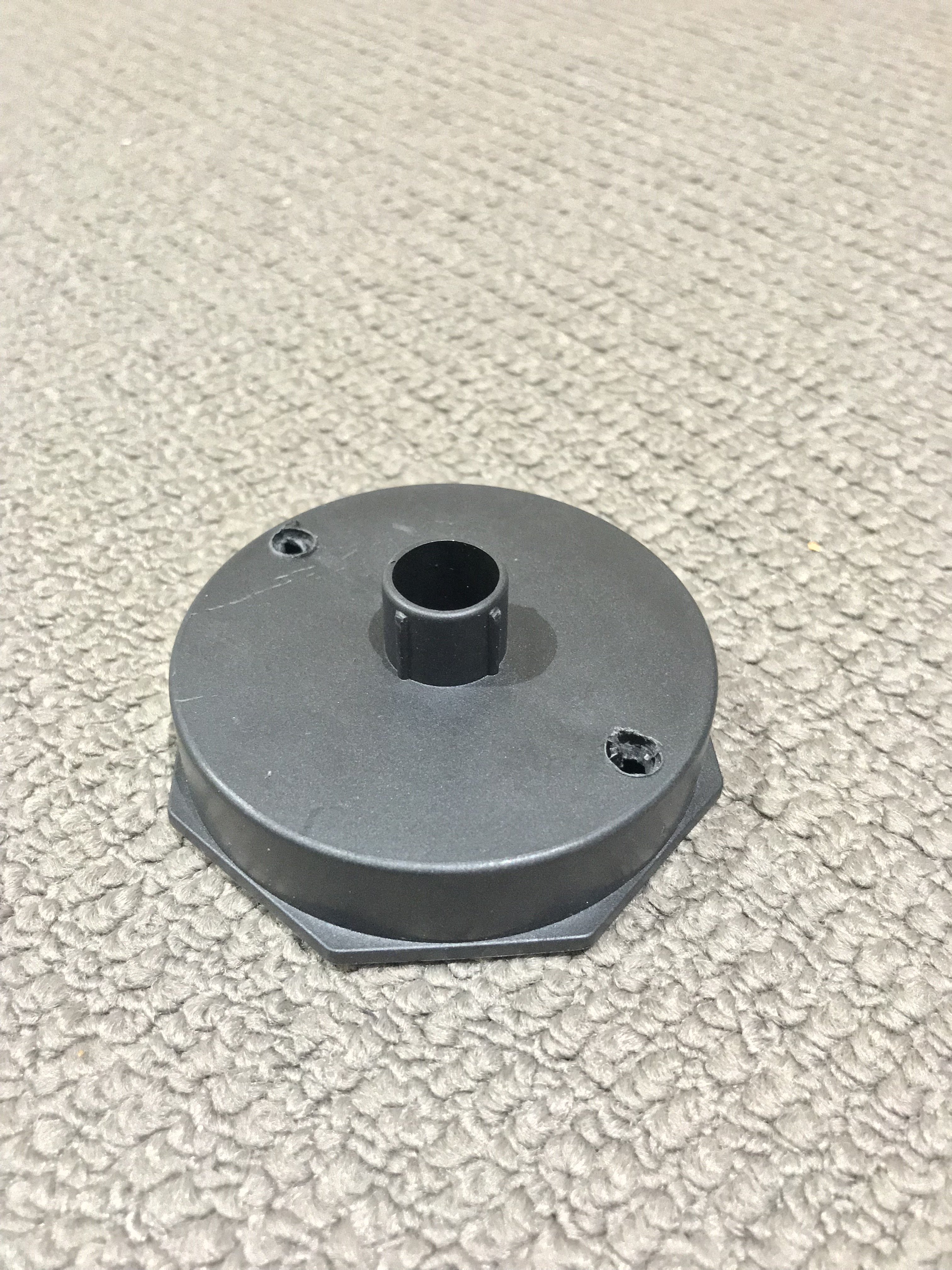

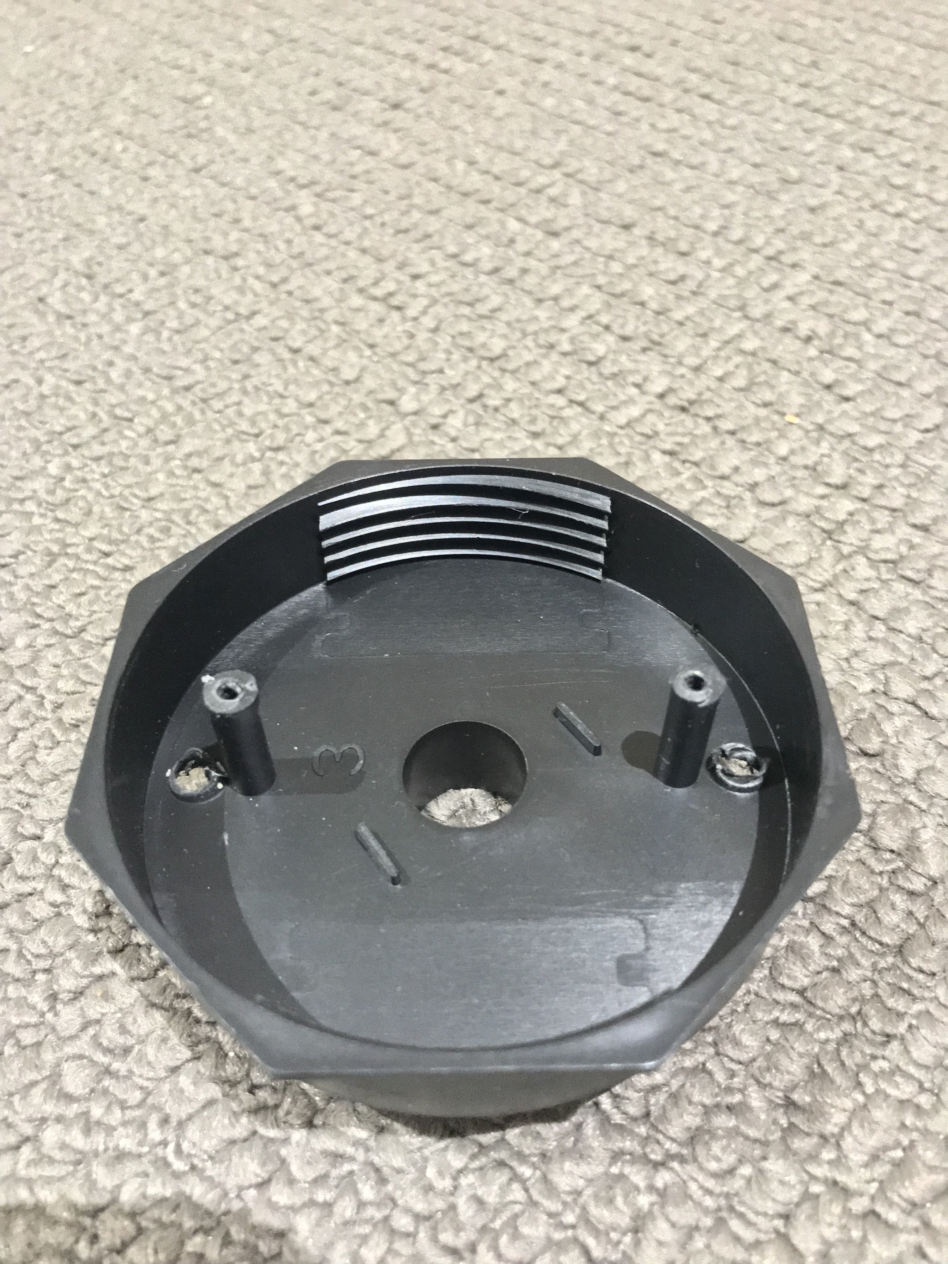

I drilled out the existing hole in the base to accommodate allow the wires to come through the base (rather then the stake). The good thing with these pixels is it comes with a plastic base with a hole so I added two pixels to a base on alternative angles, and screwed them into the post that the previous solar light was connected to. Not sure how they look yet, but I will upload a video once I have completed all 10.

Looks good Brad. I did a similar thing with 12V square nodes and it works well. 1 node was OK but 2 really gives a bright solid colour. I found by positioning the two lamps as close to centre as possible it gives a nice even diffusion without any real hot spots.
