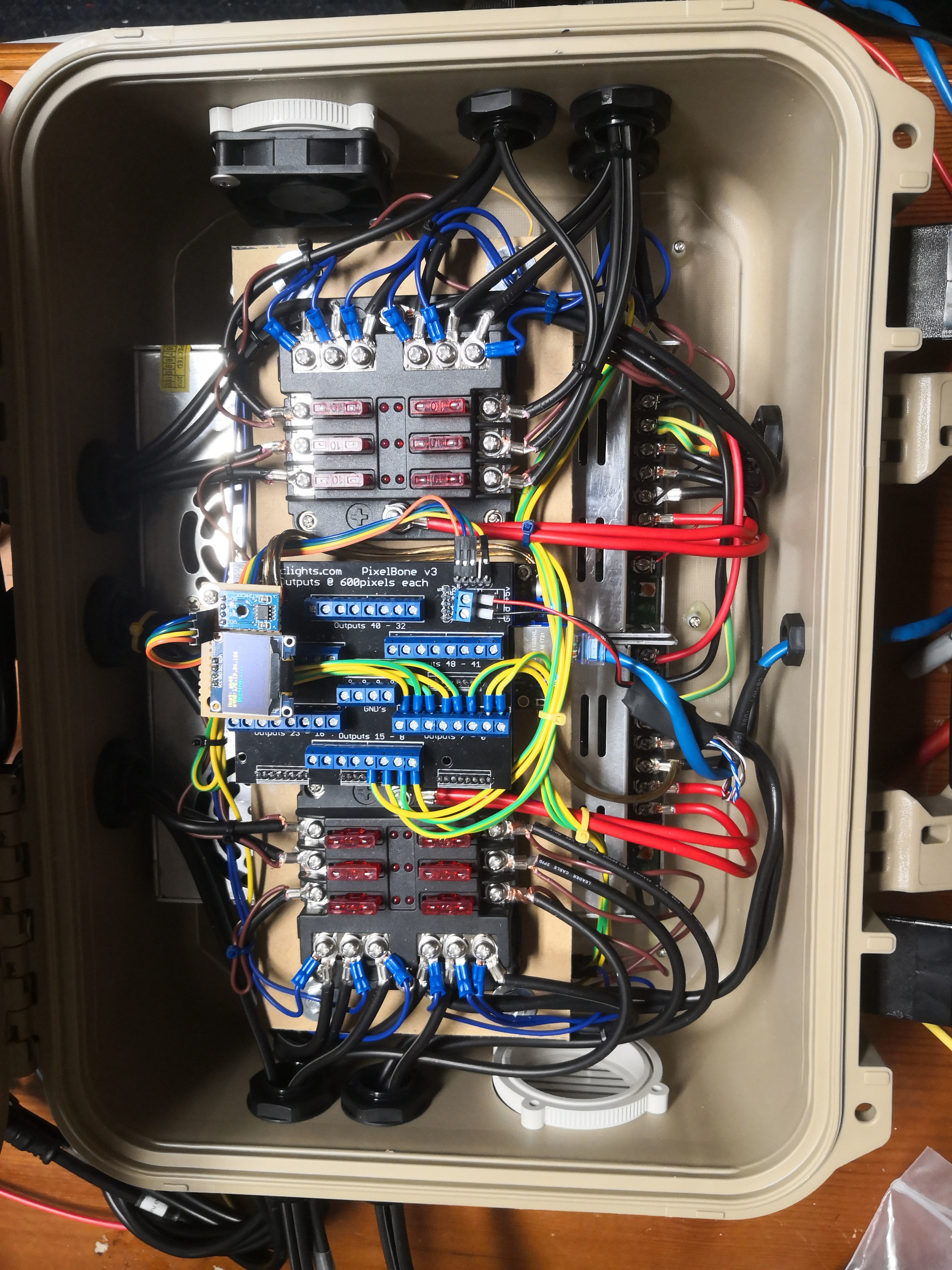

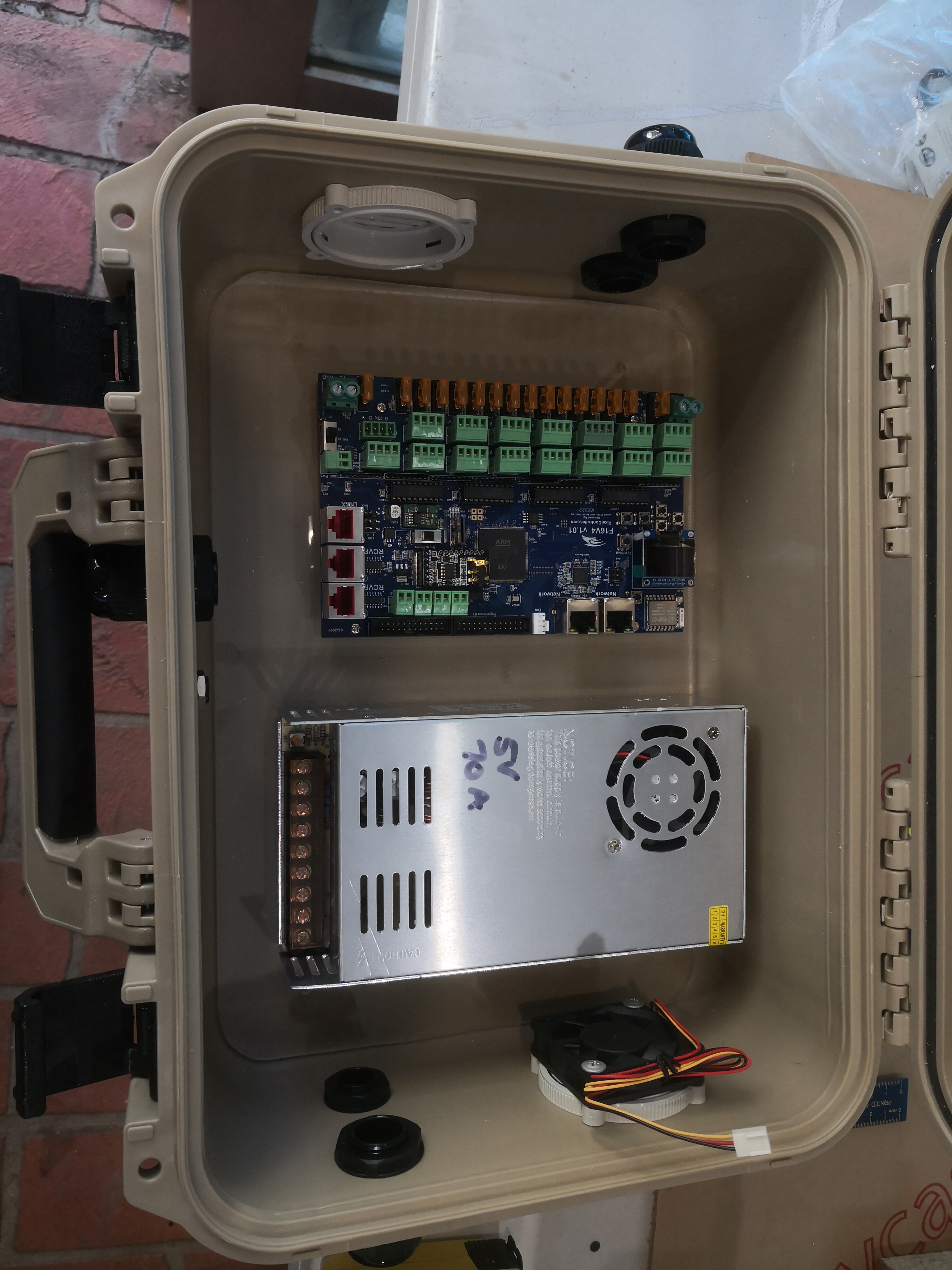

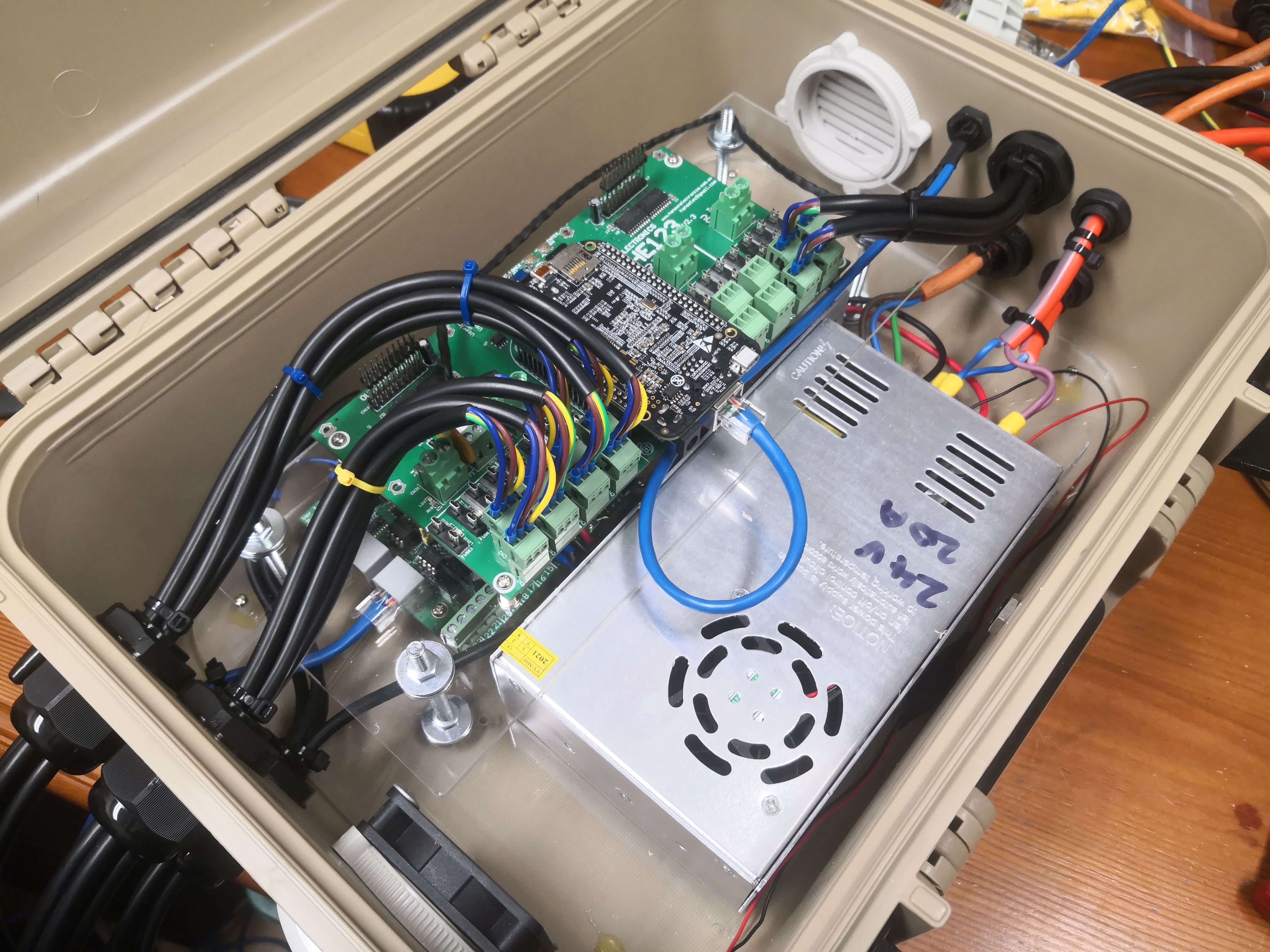

I've used a couple of these Tactix Tan cases in large for mine: https://www.bunnings.com.au/tactix-tough-case-in-tan-large_p0331395
They seem to work quite well - waterproof, with the exception of a breather hole that's under the handle. This let through two drops of water with 5 minutes of direct hose spraying. Its purpose is to do pressure equalisation so that you can open the case if the outdoor pressure changes. Obviously this can be sealed up, but if you're gonna put vents on it because there's a PSU in it, then there's not much point.
This one has 2x power supplies underneath, and the upper deck has two fuse blocks and a PixelBone48 controller.
This has 1x PSU, 1x DMX2-24, and a 31V boost PSU on the bottom deck, and a HE123 on the top deck
And finally this one has a single deck - one PSU and an F16v4 in it. It's been finished, but I haven't been bothered to get pictures.
