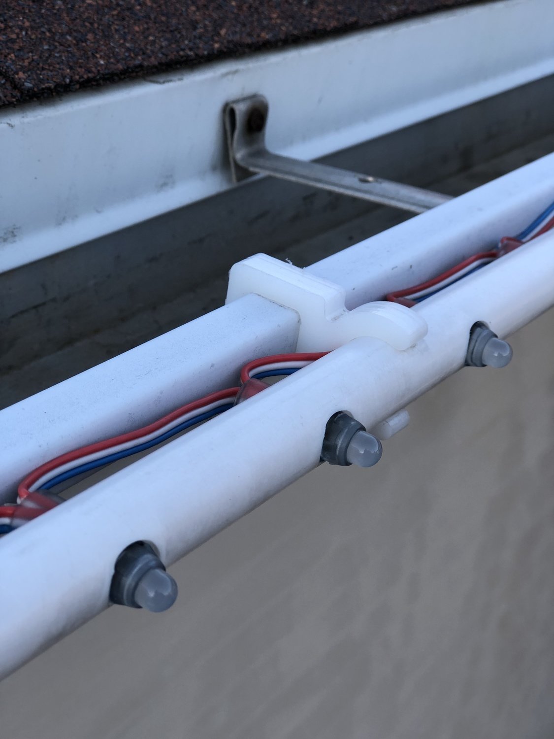

I was wondering if anyone has any ideas if it is possible to purchase gutter clips similar to the below. am using strip attached to 20mm conduit/pvc and want an option to be able to put them up and down each year, not a permanent fixture.
These look to be custom made to fit their particular gutters so not sure if they would work for my gutters. They also seem to be US based.
The other question I had was how many clips per meter people find work for hanging conduit on gutters so I have some idea how many I would need to purchase?
If I am unable to purchase I was wondering if anyone has ideas for making clips similar to the above?
