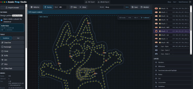

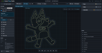

Hi everyone, I’ve been working on a new browser-based xModel design app called Aussie Pixel Studio and wanted to share it here. It’s meant to make pixel prop layout and wiring visualization easier, especially for folks who want a more visual CAD-style workflow than the usual spreadsheet/grid-based xModel editors.
What it is
Aussie Pixel Studio aims to be a lightweight web app for designing xModel pixel props. It focuses on:
  • visual node placement
  • wire/connectivity layout –(only basic at the moment)
  • xModel import/export compatibility
The goal is to feel more like a vector/CAD Designer than a spreadsheet editor / grid based editor.
How it works
  1. Open the app in your browser
  2. Import a background image or several as reference
  3. Import an existing .xmodel file to modify or start a new prop design
  4. Use the canvas tools to place pixels/nodes and draw pathing
  5. Use the Pattern tools to lay down nodes across the drawn paths etc
  6. Adjust spacing, node order, and visual layout
  7. Export the finished design back to .xmodel
It also supports importing SVG backdrops so you can trace outlines or existing prop shapes while you design.

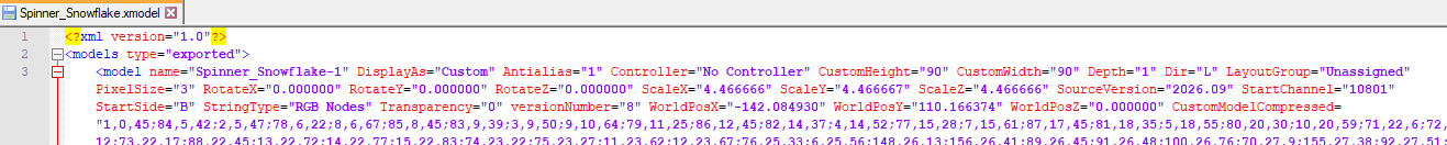

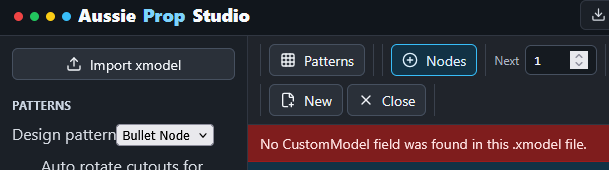

I went to edit a custom prop that I have been working on and which I saved a copy of a few days ago. When I went to edit this prop to have a play with it via your app I got an error which I pasted a screenshot of below. I know it's a custom model as @Bernie_H and I created the model and submodels. When I opened the xmodel I noticed that instead of the CustomModel that the app appears to be looking for there was an "exported". I could probably just edit the xmodel with Notepad++ and get it going but it'd be nice if that model type was allowed.

Give it a try now, i didn't realise xlights updated the custom model, i've run an update and it should accept the newer style now.
Prolly added a few more bugs in in the process but should open

Hey Al,
That fixes the ability to bring in an exported xmodel :)
