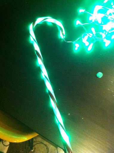

First attempt at bending
What method did you use for bending. From people that are use to this type of work and some web links that were shared with me by other ACL members it appears for best bending results you plug the end of the tube, fill and pack it with sand, seal the other end, then heat it until soft and bend. I had a suggestion from a neighbor where to find an oven large enough for this project. I will try to track one down next week. The suggestion was a cabinet/countertop manufacture. These type of companies are suppose to have 3 foot by 12 foot ovens that are top opening for heating up and working the countertop materials. Will keep you posted on findings.
Bird , I just used a heat gun to test how easy it would melt and bend. It was very easy and only took
About 5-10 secs at 600 degress. Next test will be the sand compacted in it as I have also heard that is the best way. First of all I need to build a decent jig up for my arches.
